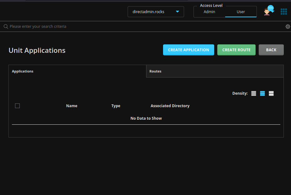

At the User level, you should be able to access Advanced Features -> Nginx unit.
Nginx Unit
There are 2 primary actions you will perform in this interface. You will create the application and then create the route. You must first create the path to your application and upload the app, both with the proper permissions and ownerships before you create the application using the path and entry script. Note that the entry script may need to be executable.

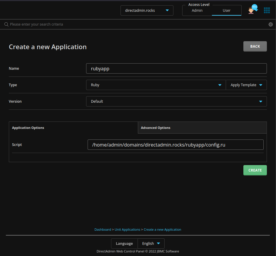

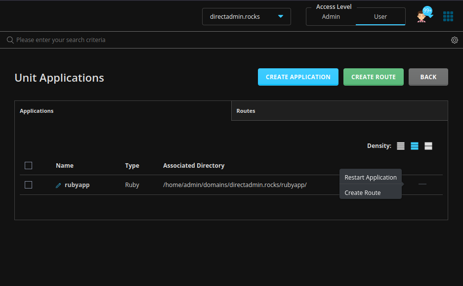

Create An Application ​
To create the application, click the Create Application button. Fill in all details for your application and create.
Create an Application

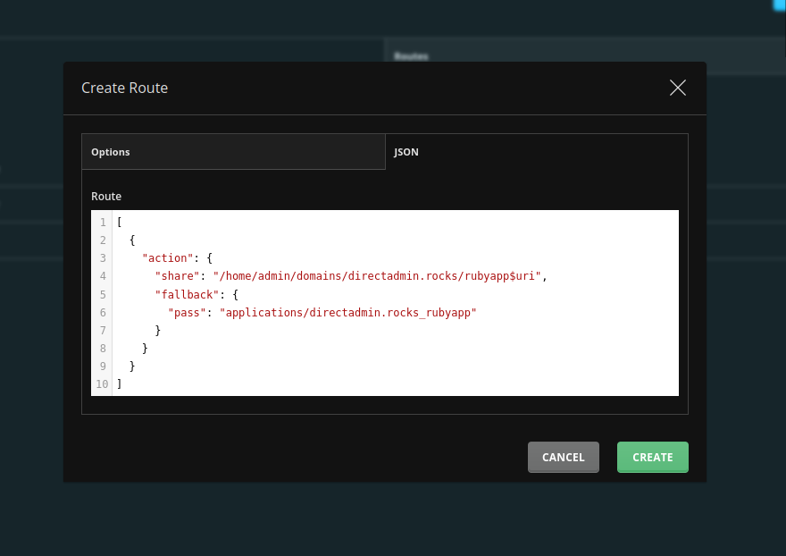

Create A Route ​
After creating the application, you can then create the route. You can click the button Create Route, or you can list the applications in the main Nginx Unit dashboard, then click the plus sign next to the application you're creating the route for, then click the option to create a route.
Create a Route
Most of the details will be filled in for you completely, if not all.
You also have the option to manually edit the JSON if needed.
Edit Route Json

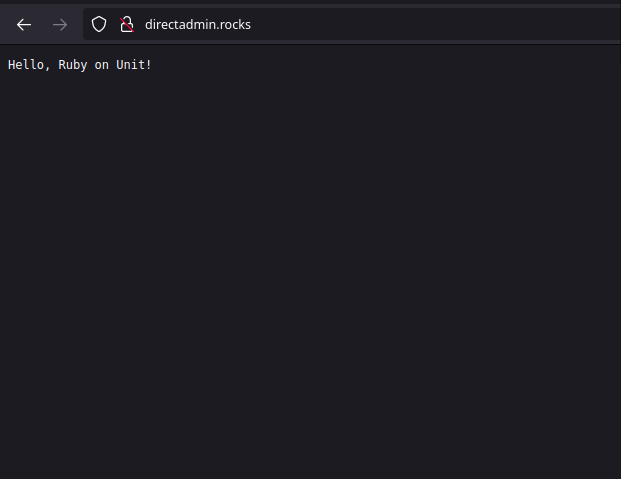

Test the Application ​
Allow a moment for everything to load before you proceed with testing. Then simply load the domain in the browser!
Browser Test
