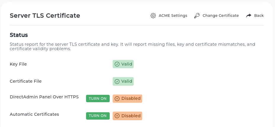

Server TLS Certificate Status
If automatic certificates are not enabled on the server, a "Turn On" button will be visible. This button provides an easy way to enable the default automatic certificate configuration and issue a server certificate immediately.
Advanced automatic certificate configuration options are available in the "ACME Settings" page.
A certificate status page can also be used to enable TLS for the DirectAdmin web interface.

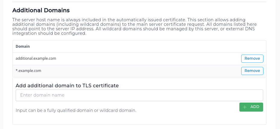

Adding more domains to the server certificate
A server certificate can be configured to include more domains in addition to the server hostname.
Additional domains can be configured in the Server Manager -> Server TLS Certificate -> ACME Settings page.
ACME Settings, Additional Domains section

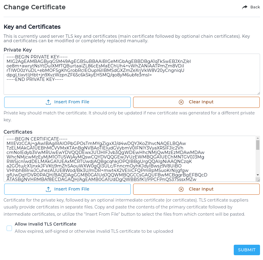

Using external (commercial) TLS certificate
Configuring an already acquired certificate as a server certificate can be done in the Server Manager -> Server TLS Certificate -> Change Certificate page.
Change Certificate
