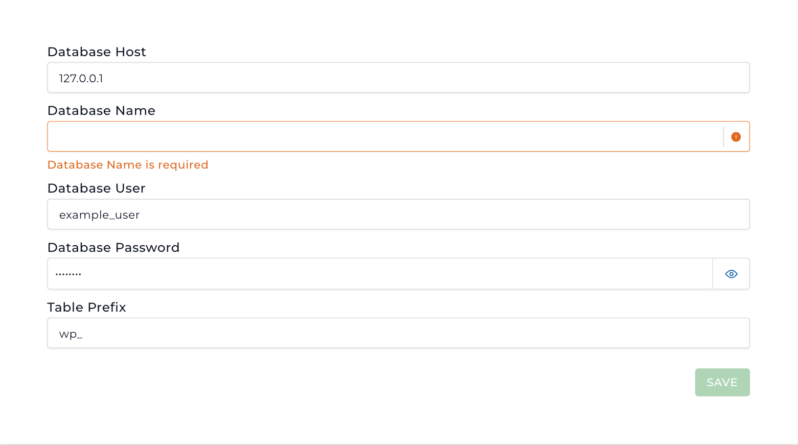

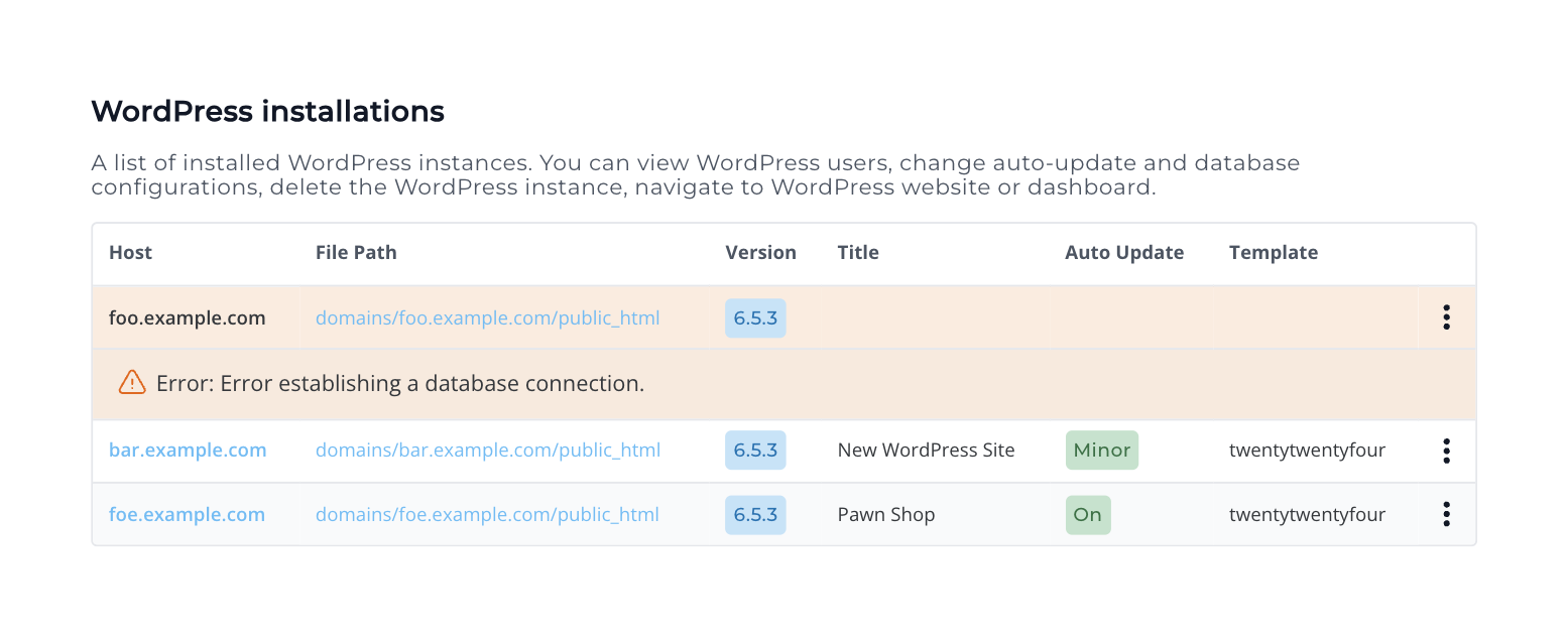

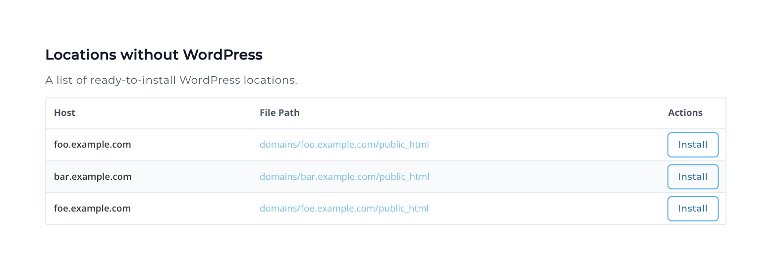

Improved WordPress instances list page evolutionupdate
In this release, we've made the WordPress instances list page more user-friendly and more visually appealing with key differences:
  • When there's an error with a WordPress configuration, we now highlight the affected database row and display the error message directly below it. This is a change from the old method where databases with issues were placed in a separate table.
  • Eliminated the use of dialog boxes for certain actions, moving to a more integrated approach with Configure Auto Update and Manage Database Configurations.
  • The Configure Auto Update feature has been integrated into the page as an expandable table row, making it easier to access without leaving the context of the list.
  • The Manage Database Configurations option has been given its own dedicated page.
Pending WordPress instancesPending WordPress instances
Installed WordPress instancesInstalled WordPress instances
Manage Database Configurations pageManage Database Configurations

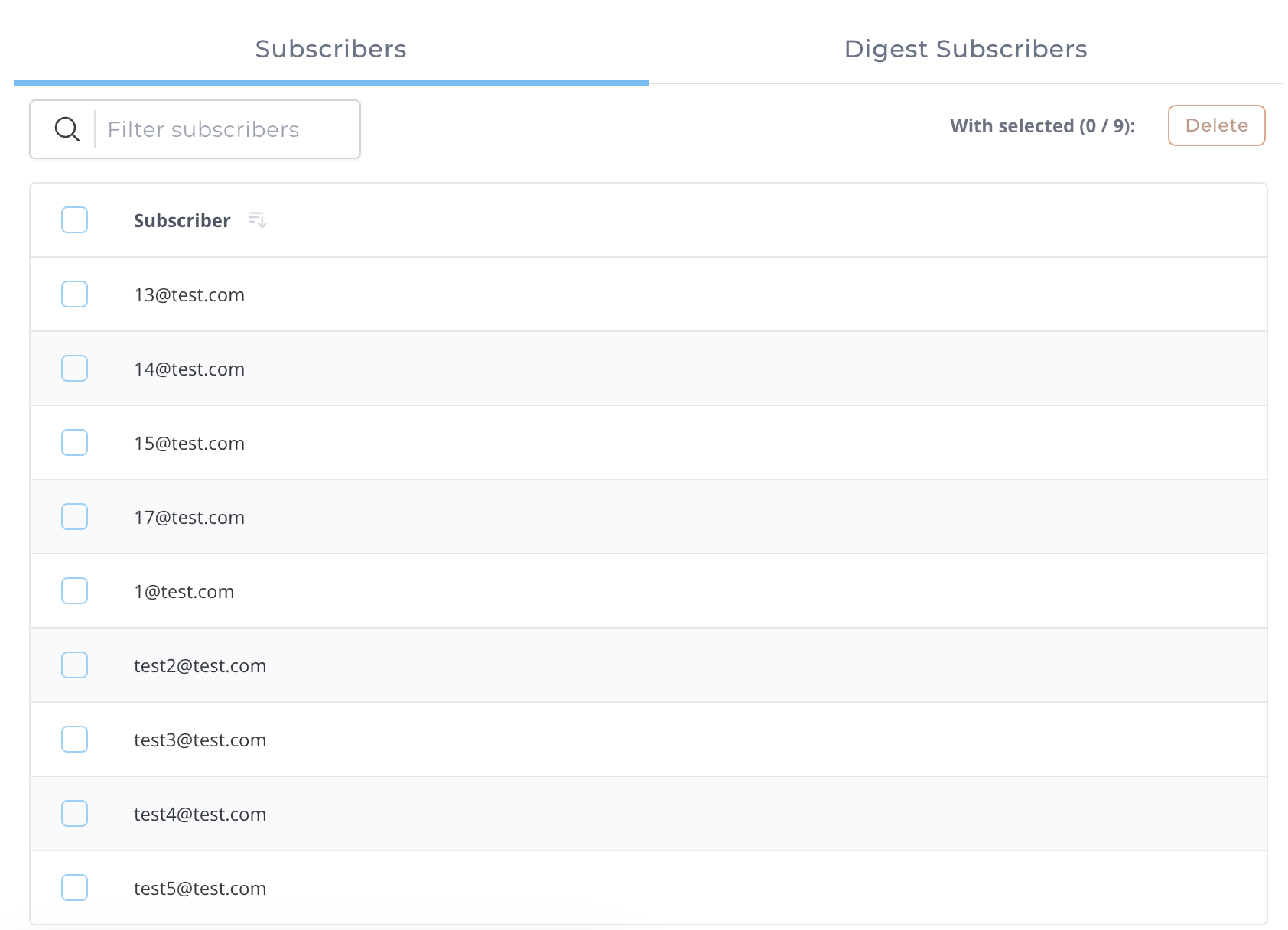

Display all subscribers in mailing list evolutionupdate fix
Within mailing list view page (accessible by going to E-mail Manager -> Mailing Lists -> and then clicking any mailing list name in the table) the subscriber table previously displayed a limited number of subscribers. If within a different page user had set another similar looking table to display (for example) 10 items per page, the mailing list page would also display only 10 items, without options to change the number of subscribers shown per page or ability to navigate through table pages.
The old table has been replaced and pagination completely removed. Now all subscribers are displayed within the table and a filter at the top of the table has been added which allows quick lookup based on e-mail.
In addition to that the following changes/fixes have been made:
  • adding an email address to regular or digest list, automatically switches user to that tab
  • switching domains while already inside the page no longer breaks api requests
Example of what the page now looks like is given below:
Mailing List View Page
