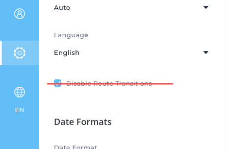

Fade-in/fade-out animation when navigating between pages removalevolution ​
Fade animation when navigating between pages in Evolution skin is removed. Skin option to disable these animations is removed as well with the new default being no animations.
Removed Disable Route Transitions
