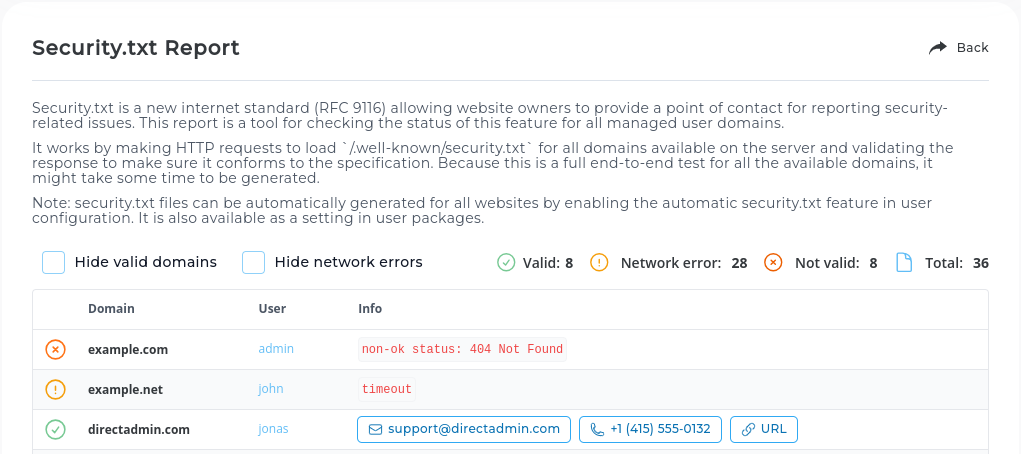

Security.txt report new
A new page called Security.txt Report is now available for Reseller level and Admin level accounts. It reports security.txt (RFC 9116) compliance and availability for all the domains.

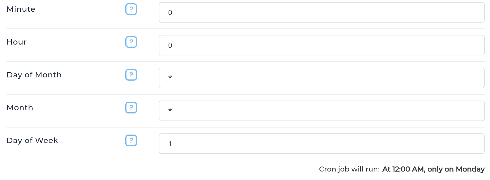

Cron input hints evolutionupdate
All pages that create cron jobs will now show a message that lets the user know when a cron task is scheduled to run.
The screenshot below is an example from the cron job creation page (user level -> Advanced Features -> Cron Jobs).
