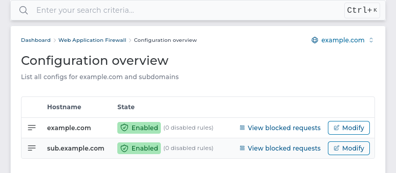

Improved web application firewall (ModSecurity) page evolutionupdate
The user-level ModSecurity page is updated and renamed to Web application firewall. The updated page makes it easier to quickly check the state of the web application firewall on user-owned domains. The overview of all hostnames is especially on the ModSecurity admin-level page.

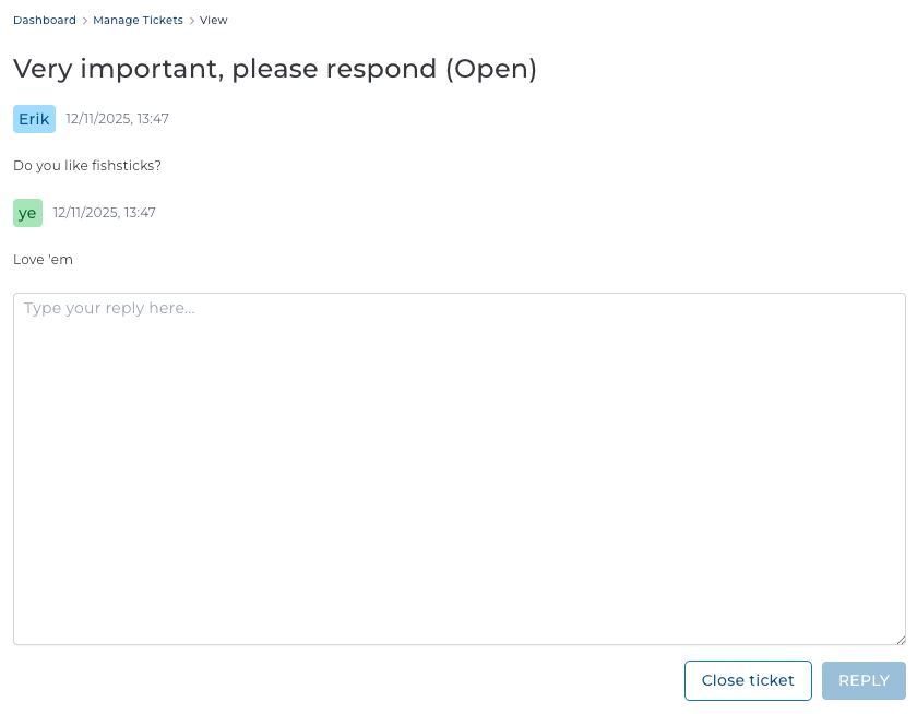

Replace ticket correspondence dialogs with their own pages evolutionupdate
Both reseller and user level dialogs were replaced with new pages.
