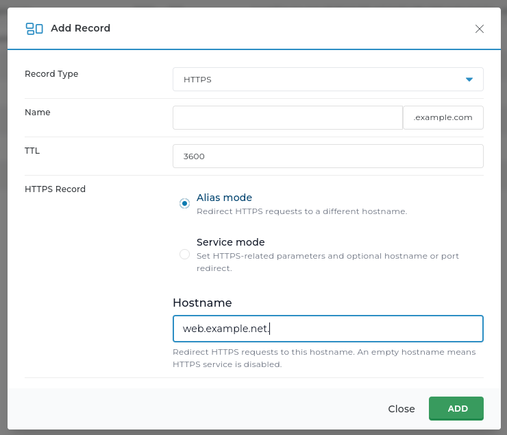

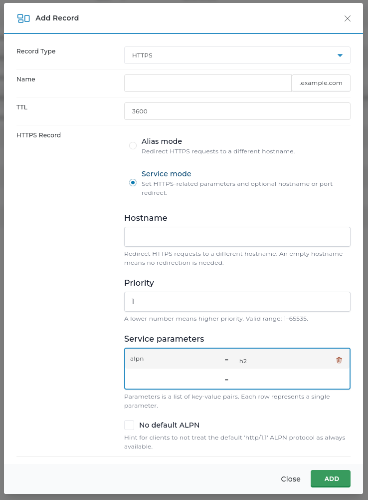

Support for the new DNS record types HTTPS and SVCB new ​
A new DNS resource record types - HTTPS and SVCB (RFC 9460) is supported by DirectAdmin. These DNS records enables the following features:
  • Redirect HTTPS service to other host name (alias mode).
  • Inform web browsers about HTTPS support and pass extra HTTPS parameters (service mode).
  • Allow storing ECH data in the DNS.
The availability of the new DNS record type in the user interface can be managed with a new dns_https and dns_svcb configuration options. Support for the new record types are enabled by default.
The default DNS HTTPS record set for new domains can be configured by creating a customised copy of the data/templates/dns_https.conf template file or data/templates/dns_svcb.conf template file.
New HTTPS record (alias mode)New HTTPS record (service mode)

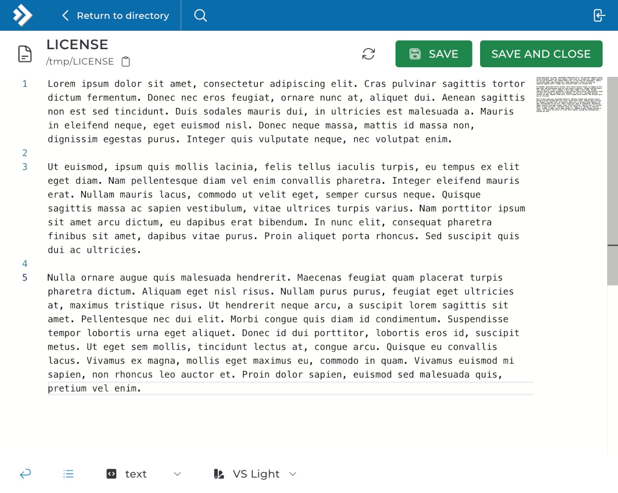

File Manager file editor redesign evolutionupdate ​
The File Manager file editor has been redesigned with several key changes:
  1. It is now a separate page instead of an overlay modal.
  2. You can now copy the full file path using a button in the toolbar.
  3. You can now navigate to other directories directly from the editor using the folder tree in the sidebar. On mobile devices, you must first return to the directory view because the floating button for opening the folder tree drawer is disabled while the editor is open.
  4. Editor options and switches have a refreshed, more modern design consistent with other editors. Switches use the primary color for on and a muted grey color for off. Dropdown selectors kept the same available options.
  5. Removed the Save File As option, as it was deemed no longer necessary.

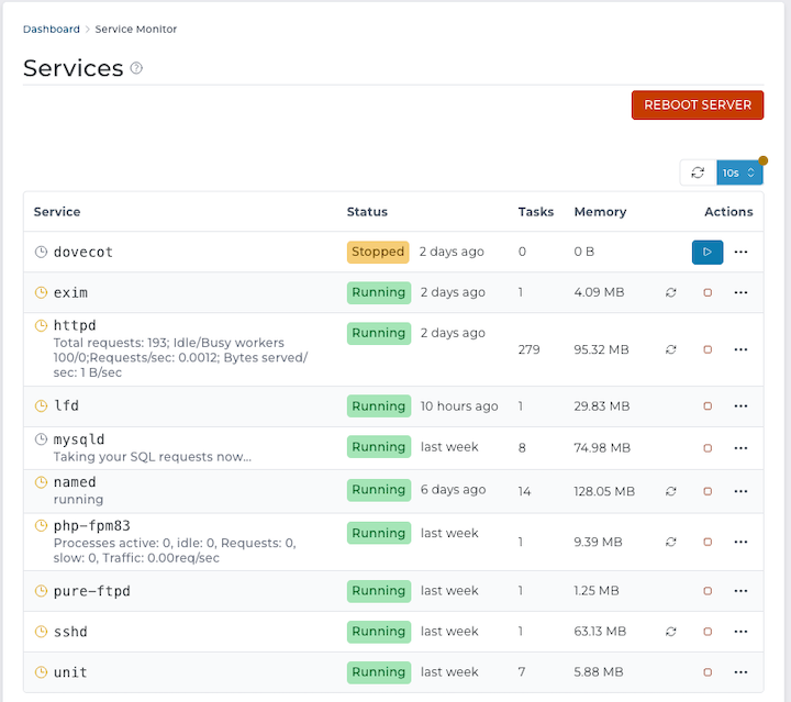

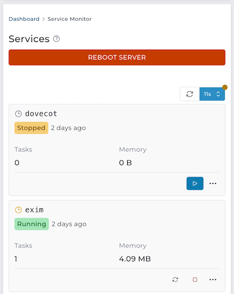

Updated service monitoring page evolutionupdate ​
The service monitoring page now features a refreshed design, improved mobile experience, and auto-refresh functionality.
