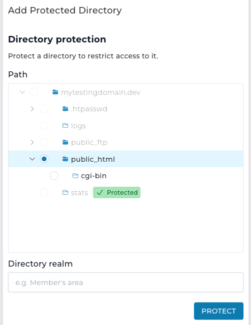

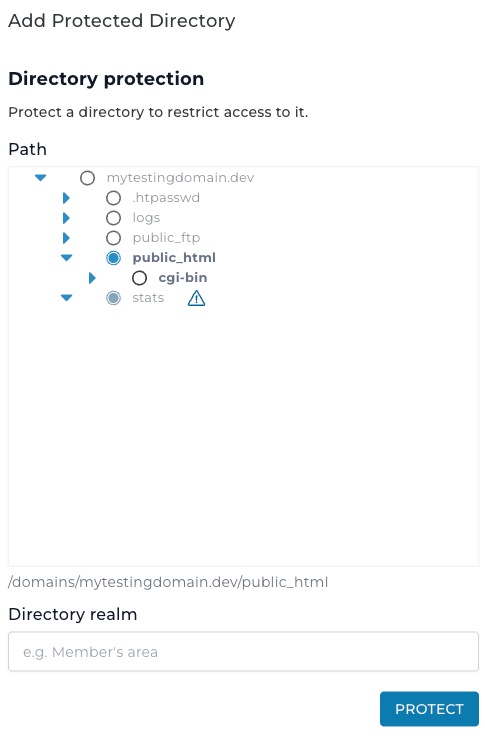

Protected directories add improvements evolutionupdate
Updated the protected directories view with a modernized tree selector featuring improved accessibility and full keyboard navigation support.
Before the changes
Old add protected directory
After the changes
